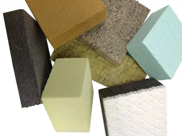

Most Used Materials for Internal Wall Insulation
A wide range of insulation materials, including natural, mineral, and synthetic ones, can be used for internal wall insulation. The choice often depends on the type of intervention:
- For dry lining insulation, materials like rock or glass wool are commonly used due to their mold and moisture resistance and acoustic insulation properties.
- For panel insulation, cork panels are excellent due to their natural, sustainable, and renewable properties, along with being anti-mold and anti-condensation. Other commonly used materials include polystyrene and expanded polyurethane.
- For foam insulation, initially liquid materials such as polyurethane resin, urea resin, or phenol-formaldehyde are typically used.
The best insulating materials for internal walls in solid masonry
There is no universal material: each solution must be evaluated based on the characteristics of the masonry, climatic conditions, and the goals of comfort and energy savings.
Among the most commonly used materials, mineral wool panels, both rock and glass, stand out for offering good thermal and acoustic performance, high breathability, and fire resistance. Their fibrous structure helps limit thermal bridges and easily adapt to irregular walls, making them particularly suitable for renovation projects on historic buildings.
Natural insulating materials, such as cork, compressed wood, or wood fiber, are gaining more traction due to their sustainability and excellent thermo-hygrometric properties. These materials, while often requiring a slightly greater thickness compared to synthetic insulators, help regulate internal humidity, reducing the risk of condensation and mold formation on the walls.
For projects where internal space is limited, expanded or extruded polystyrene panels provide high insulation value with reduced thicknesses. However, their low breathability requires special attention to wall ventilation and possible integration with vapor barriers, especially in the presence of brick or solid stone masonry.
Another innovative solution is represented by aerogel materials, characterized by extremely low thermal conductivity, which allows for high insulation performance with minimal thicknesses. This technology, although more expensive, is particularly useful in renovation projects on protected buildings or in spaces where every centimeter of internal surface is valuable.
Materials for thermal insulation with coat
