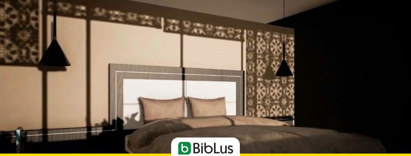

With the following detail videos, you can see how a decorative screen-printing detail was applied to different material types within the Casa del Viento project, a contemporary residence in the town of Tepoztlán, Morelos, Mexico, and designed by the “A-001 Taller de Arquitectura” architectural design firm and re-modelled with the Edificius BIM software for architecture.
Behind the scenes: glass screen-printing techniques with a BIM software
Here we’ll see how to create the screen-printing effect on glass, embroidery on fabric and laser cut patterns on metal, using a unique function available in the program: Alpha masking
  • 00:00 min – here we’ll select the glazed wall and, in the material category, open the relating editor; right mouse button click to add and name a new item by choosing the Glass option;
  • 00:27 min – by clicking on the RTBIM node, we will be able to preview the effects of the current settings and in this same viewing environment, see the changes we are about to make. As a first step, in the Alpha Mask Map category, we’ll upload the image map that contains the screenprint pattern. We’ll set the texture size at (1.3m x 1.3m), set the appropriate amount of transparency and then set the Alpha Mask Map to 90%. If necessary, we can even invert the image map to get an inverse pattern on our material;
  • 1:10 min – confirm choices and return to 3D;
  • 1:16 min – in the Materials category, and in particular in the Project BIM Objects Library, we’ll select this new material and apply it to our glass wall.
Screen-printing on a fabric base with a BIM software
The process for reproducing a fabric embroidery is the same as seen before with the screen printing technque on glass. The only difference, in this case, would be that the starting material would have to be a fabric texture, upon which we’ll add our pattern using the Alpha Mask Map.
Screen-printing on a metallic base with a BIM software
Again, same procedure as before but this time used to simulate laser cutting on a metal panel.
