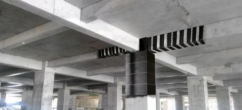

Reinforcement with Fiberglass and Carbon Fiber
Fiberglass and carbon fiber offer lightweight and effective seismic structural reinforcement. Steps for application include:
  1. Preparation of the support to be reinforced;
  2. Application of primer and adhesive for structural fixing;
  3. Positioning of the fiber fabric;
  4. Impregnation of the fabric to enhance adhesion.
To learn more about these materials, I recommend reading the in-depth article “Carbon Fiber in Construction“.
Structural reinforcement of a beam with carbon fiber elements
