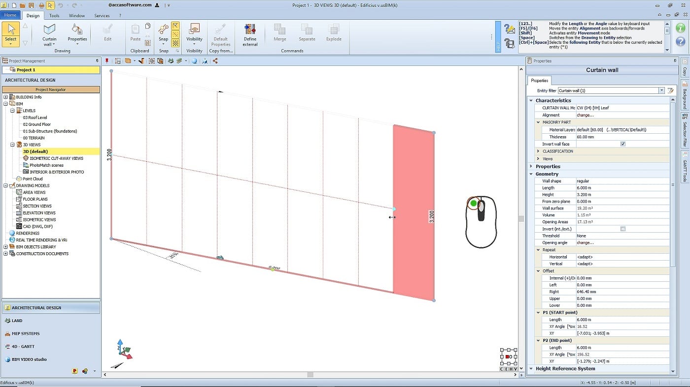

To design a double skin facade, it is necessary to evaluate a series of fundamental parameters for the successful outcome of the project. First, one must start from the 3D modeling of the building. With a building design software, you can model the facade in 3D using the specific BIM parametric object. You have a rich library with many models available that you can also customize according to your design needs.
Continuous facade Edificius
