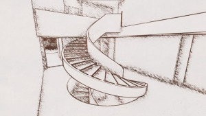

While remodeling the various spaces and objects, an interesting aspect was designing the spiral staircase of the Edificius BIM Objects Library house’s ground floor.
Modelling staircases
By adopting the architectural element staircase we were able, thanks to its editor, to give it a spiral shape. On the other hand, by adopting the wall element we managed to insert the railings.

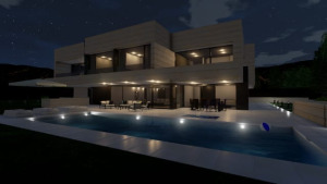

Modelling the pool
To design the outdoor pool the pool element was inserted into the ground.
This automatically calculates the cut in the terrain according to its relevant placement. The bottom, at variable levels, was obtained by using and modelling the staircase with landing and ramp architectural objects.

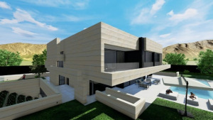

Modelling terraced elements
Another interesting solution, ingeniously addressed thanks to the BIM software Edificius, was how the terraces were designed. These were supposed to give an external view and bring in some extra light to the undergorund floors.
Thanks to the ground movements in the terrain environment we managed to assign the desired elevation to each riser. For the terracing to be fully integrated in the surrounding context, trees and bushes were inserted by means of the vegetation tool. After completing the Project, the high definition textures were applied.
