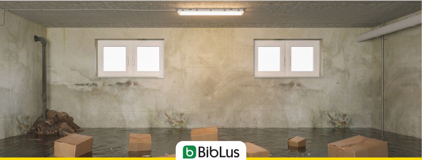

Waterproofing Interventions
In the context of basement renovations, managing moisture is of fundamental importance to counteract rising damp, water infiltrations, and the presence of Radon gas. The walls of these structures, being below ground level, require an effective technological approach to keep the environment dry and healthy.
The most effective approach, when possible, involves external intervention, creating an aerated cavity along the perimeter of the structure. This aerated cavity is then waterproofed to ensure complete protection, filled with a drainage layer, and equipped with suitable piping to drain water away from the building walls.
If external intervention is not feasible, an aerated crawl space can be used as an alternative for internal intervention. This can be accompanied by direct treatments on the walls, such as removing existing deteriorated plaster and applying dehumidifying plasters and chemical barriers, depending on specific needs. The issue of moisture can also be mitigated by using air handling units (AHUs) or constructing counter-walls with an aerated cavity and ventilation holes.
